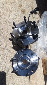

These came today though..I was gonna go with advanced for the cv axles but I saw Detroit axle had 2 remanufactured cv axles and 2 new wheel hubs for the same price I would've paid at advance for just the cv axles...figured I'll give them I shot..I've been reading some bad things about Detroit axle shaking at 60 and above..we'll see these came today I guess I'll get the axles tmrw glad I got the wheel hubs though the passenger side ones had some play in them

Detroit axle hubs are decent especially if you take advantage of there warranty. So make sure you hold on to the paper work for them. I think I've been running this set of Detroit axle hubs for the better part of 2 yrs with now issue. My brother-in-law wasn't so lucky with a set so he switched over to moog and we'll see how those work out.

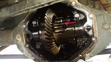

That seems like an awful lot of material on that magnet..is this normal?i think I'm at 147k miles on the odometer I gotta check.

I've seen a lot of people saying it's ok to reuse the old gasket but I'm not liking the the looks of this one at all..plus it's 20 bux on gmparts direct so I'm guessing that's what it would cost at the dealer..hopefully they have it in stock when I go pick up the lock ring clips tomorrow

Also this doesn't look right to me..that exposed spring there..anybody know anything about this..I did have have an occasional knock when I switched to and from reverse and there's some serious backlash..I can spin the wheel almost an inch before the gears engage

If the oil was never changed, I would consider that amount of fine particles on the magnet as normal.
I can't tell if there anything wrong from your pics as they are kinda dark. Here is what a new one looks like.
I second that about the particulate the magnet caught. Looks normal, its fine particles, not large chunks. that's how its supposed to look.

@Mooseman @BrianF thanx for the info I had the truck 7 years and this is the first time I've done it..doubt the previous owner did anything based on how much neglect I've seen doing these repairs I'm doing..moose,I'll spray down the diff with some brake cleaner to get a better look..I see that exposed spring in the pic you sent so I guess that's what's its supposed to look like.
