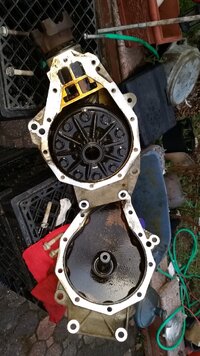

Bought junkyard front differential..was I robbed?
Spray down with brake clean or wd-40, then follow up with a air gun. Most will come out, and what doesnt will be caught in the filter. I would use this opportunity to go ahead and replace the pick up. Its easy while you are here. And its a common enough problem to just get ahead of the gun while you are here.
@coolasice @coolride ive had the truck since 2013 and I never put fluid in there and I don't know how long that crack was there or if the previous owner put fluid in,So all type of water got in there..those bolts were definitely banging on the housing and getting smashed up..that was part of the noise that caused me to look into it..I thought is was a wheel bearing at first

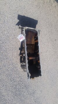

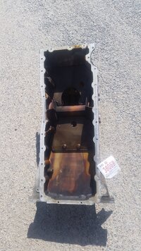

Here's an oilpan I picked up today at a salvage yard for 50 bux and the junkyard diff I picked up a few months ago..I'm gonna give them both a cleaning tmrw especially the inside of the oil pan, that part on the right was in the oil pan..what's it called? I know what it is and what it's for just don't know what it's called..wondering if it's worth anything, I'll clean it up and sell it.I've got the oilpan soaking in some la's awesome degreaser overnight right now but any favorite or recommended cleaning products would be appreciated

That's the main caps "ladder". It's to stiffen and stabilize the caps.

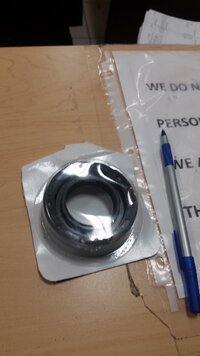

That appears to be the seal to me, and it will be a problem. The seal is like 18 bucks from the GM dealer (dont get one anywhere else on this one). Most dealers have them in stock.
@coolride yeah thats the junkyard diff..im gonna follow you and @TollKeeper advice and go check the dealer..got the oilpan and diff cleaned up decent. Gonna give the oil pan a little once over in the morn

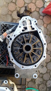

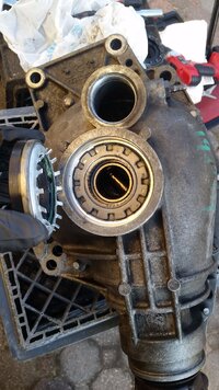

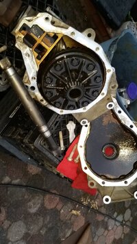

Also after about a half hour of wondering what the the hell am I gonna do to get the intermediate shaft out..I said to myself "hey dummy why don't u take it apart like you did the old one" so I did that and 3 taps with a hammer and it popped right out..question...should these get any sealant/gasket material between the halves when I put them back together? I would think so since there is fluid in there and it doesn't look that watertight to me

Checked in GM-SI and it says to use sealant. Permatex Grey would be a good choice for this.
The boss inside the oil pan where the dif sits, and where the disconnect sits. That looks like it needs a good cleaning for corrosion, and a once over with some non-water salable grease to prevent further corrosion once you go to install the setup.

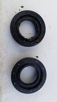

Got the seal any special tools needed to remove/install?

Why does that look like the wrong seal... Is that the gasket for the torque tube, or the cv axle side?
Forget i asked..pry bar and my left foot.@tollkeeper the left side..the one that goes straight to the cv axle..looks the same to me

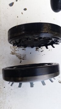

Aside from those smashed down teeth..good call guys glad i replaced that..18 bux including tax
There actually MORE expensive to buy from any other parts store that I have been able to find.

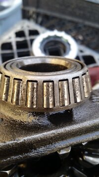

@TollKeeper really? Thats odd..probably gonna get new bearings too one has a lot of small pitting on a few of the pins and one has a decent size piece missing on one pin

After reading the work involved to adjust pinion depth, I wouldn't mess with that at all.

Am i supposed to put any grease in between these two parts or does the fluid lubricate them
No, Those teeth interlock in that other plate to prevent movement

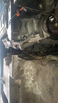

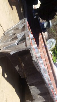

Check this friggin disaster out..how the hell did any of us not notice this..junkyard oil pan was broke..i checked the earlier pics and there it was.. so i know i didnt do it..the rear pass side that connects to the transmission...SUM B×××CH..just gotta laugh at this point..they said 30 day warranty when i bought it so heading back to hear their story now

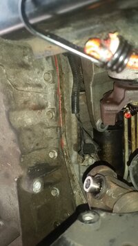

Had it all put together and was torquing the nuts when i noticed..didnt put the transmission bolts in on sunday cause it got dark on me and since theres no gasket on that part i figured no big deal I'll put them in later

Just an FYI, you're supposed to tighten (not torque) the oil pan to transmission bolts first so it is flush with the tranny. Then you torque down the pan to block bolts and then the pan to tranny bolts.
Wait... What? Gotta remember, I have never worked on a 4.2. But do the tranny pan and oil pan overlap or something?
Not the tranny pan but the bellhousing. The tranny bellhousing goes all the way around unlike the V8 which is split. So the bellhousing pattern on the block extends all around via the oil pan.
Got it moose..i will follow that procedure..they gave me money back and sent me to an affiliate to get a replacement same price..this one has baffles in it and the tag said 03 trailblazer (ive got 04 envoy)..looks the same otherwise has any one seen this b4? should i be concerned?
