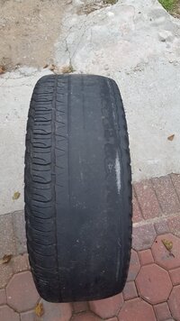

So here is one of the wheel hubs from detroit axle (drivers side) that i got and posted about in this thread april 1 2020 post #123 or 122.Bought this tire 2 months ago because the one that was on there b4 looked just as bad maybe worse.afterseeing this tire i decided to try and figure out whats causing that premature and uneven wear..thnks detroit axle..wonder if they gonna reimburse me for those 2 tires
They're sending replacements..30.00 for shipping smh..not a fan of these people so far..doubt ill ever buy anything from them again. @xavierny25 any problems with those cv axles?
Haven't installed them yet and there still in the box they came in but I will be installing before the fall.
That sucks! 30 bucks for shipping, another 30 bucks and you can get another pair of hubs shipped from ebay.
So far I cant speak badly about Detroit Axle. I have a set of hubs on all 3 of my cars at the moment. I am having one problem on my Rendezvous with Unwanted ABS activation on the left front. This is actually why I replaced the hub to begin with. So it might be in the wiring, or it could be a bad hub, or I might have not routed the wires correctly, and the hub rubbed thru the wiring. Need to dig into that, but for now I just deal with the light. I injured my back, so working on cars is a extreme low point on my list.
But your right, 30 bucks for shipping for something with a warranty. Maybe it is a better idea to go thru my local parts store.
I've had my detroits in the truck since 2016... somewhere around 20k or so on em... no issues here.
The only reason i got the replacements was because of some good reviews ive seen on this forum..hoping i just got a bad set..i just remembered that i actually had to buy a new passenger side tire 2 weeks ago for the same uneven wear..i tried to take off the passenger side but the rain stopped me..ill check it tmrw..i told them to send me 2 replacements just in case..cause im sure they would of charged me another 30 to send the passenger one seperately
Sad to say but they are likely made by the same place in China as all the other cheap hubs available everywhere. I doubt very much they have them built to their specific specs, which would be much costlier. Some are better than others. I've had Raybestos hubs actually blow out within a month.
I had similar tire wear, though not quite as bad, some years ago when I installed a set of Airlift 1000s in the rear. I carry a lot of tools and the Airlift bags helped carry the weight in the rear but they also lifted the rear and that changes the alignment.
@coolride im thinking the hub cause the wear..however when i went to investigate it initially the first thing i saw was the driverside stabilizer link was disconneted..the lower nut came off..idk if the combination of no sway bar link and messed up hub and caused the wear..or if no sway link caused hub to fail

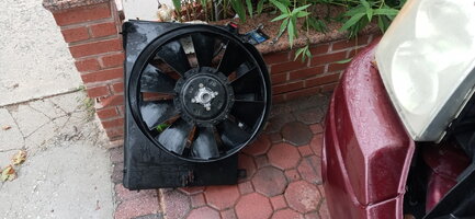

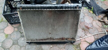

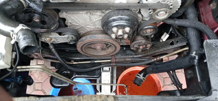

Notice coolant was low so thought i needed a top off..nope..major radiator leak and the damn thing was operating at normal temperature..do these vehicles have a low coolant warning that should come on and mine is not working, or do you just wait till it overheats and blow the engine cause i had no clue..guess i should be happy i noticed while im waiting for the wheel hub..put in the new radiator yesterday
