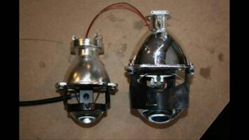

Just finished cutting the other one now I have to decide what color to do cause I only have purple leds and now im thinking of the ones we where talking about to fit and be even but I still kinda want white cause I doubt ill keep these its just something to do on my one day off while I watch tv haha I really do need help[emoji14]

Not sure yet I randomly got on ebay lastnight and won a bid with 3 mins left of an assortment for 2.27 so im gonna test them all and see what I like I won't be keeping them anyways uploadfromtaptalk1412562649316.jpg
:undecided: Is that a Matchbox I see? :cool:
You'll have to give us a review on how bright those silicone covered switchback strips are. :yes:

Yep they are the matchboxs they are really tiny but I dont like the eyelids at all and as for these tubes they are ok not super bright though and really slow on switching back and forth luckily I only need the circuit board out of one ill have to find something else to do with the rest of themuploadfromtaptalk1412629624869.jpguploadfromtaptalk1412629634523.jpg
You shall prevail brother :yes:
