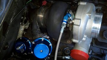

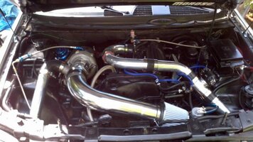

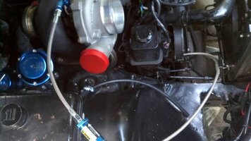

update: installing all the parts. ran thecwiring for oil temp, ran my oil feed line, ran all the intercooler piping, cut and ran the intake pipe, boost gauge is in, a new oil filter/sandwhich plate adapter, and now just need to weld a flex pipe on the wastegates so tings lining up is much less of a PITFA!!! getting first pa from new state job friday finally (4 weeks) so I can buy my MAP sensor and my Mobil 1. as well as a couple of goodies for the interceptor :) (pioneer headunit and dual 15" pyle subs)
heres some pics of the work

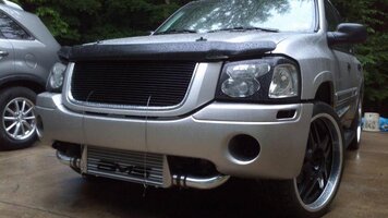

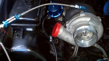

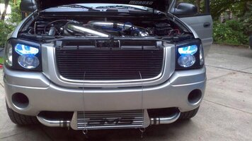

IT RUNS!!!! I just took it down the street for the first time since last winter and the :eek: :biggrin: TURBO IS SO LOUD! it sounds soooo good hahaha whistles so damn loud spooling at only 2800 rpms.
VIDEOS AND PICTURES WILL BE UPLOADED AND POSTED before 9:00 tonight ! I need to go drive it again and do some data logging.

sounds like its going to be a fun ride...... on a side note do you have plans to kinda make the inner cooler not as noticeable up front?
