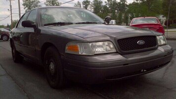

Then off to Ohio possibly to buy this daily driver:
Nice :thumbsup: They also have a white 05 with only 45,456 miles for 8K, but the Grey does look better. IMO your first mods should be tint and clear corners :yes:
[EBAY]290902141016[/EBAY]
Better yet, but more $$$
[EBAY]121108176573[/EBAY][EBAY]151051353691[/EBAY]

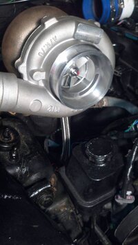

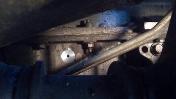

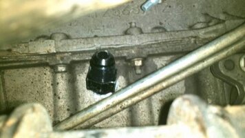

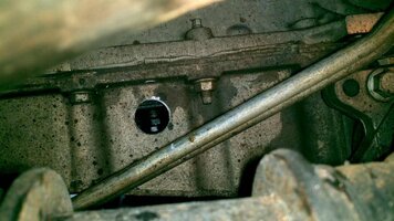

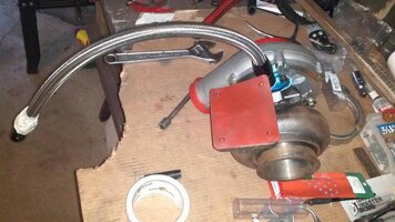

GOT IT ! haha got them down to 5,000 I go back tmrw or another day this week to pick it up and drop off my check.
Now I am just waiting for my paycheck so I can buy my new MAP sensor for the envoy and I am go to tap the oil pan and RUN THE TURBO !
