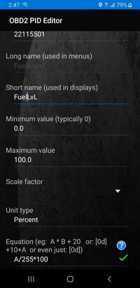

couldn't find on for fuel level
With the crossed up thread subjects I may have posted this elsewhere but anyway.....Fuel level that works for our trucks is not in Torque by default. But it is here at post #31 of More Pids for Torque...
TJBaker57
Aug 16, 2015
2,907
Colorado
So I finally got the app to see the bluetooth adapter and these are the displays I got. I couldn't find on for fuel level. Found fuel remaining.View attachment 95416
The PID torque is using here for fuel level is not supported in our trucks. Use the PID details provided in the "More PIDs for Torque" thread. You will need tonadd the PID manually through the setting menu item.

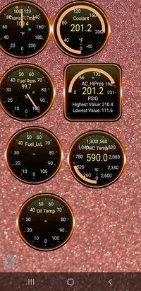

The fuel and oil PiDs don't work for me. The AC high pressure and TWC TEMP CALCULATED DO.

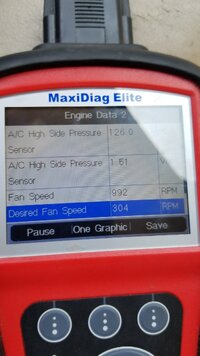

I didn't see the fan ones. Mine is a 2004
Fan speed is post #1 of the thread. Desired Fan speed is post 2 of the thread. Being the first posts of the thread it looks like I had not started listing the parameters seperate from the text but they are right in there.

I completely forgot about my Autel MaxiDiag Elite MD802 scanner that I put away with all the multimeters I have and completely forgot about. So this thing can read everything. If it did bi-direction it would be the best pro scanner for less. I can read every possible system monitor. Tranny, evap, engine on three different folders etc. It shows the fan desired and actual speed, all the trims, injectors, temps, injectors, cylinders, EVERYTHING.
So what should I look for when I get the higher temps? I know probably Fan desired speed, actual speed, RPM, car temp, trims long and short. But what about the AC High pressure I read that it also affect temps. Too bad I cannot select the monitors I want like in Torque Pro. But I can film it and show it while scrolling.
Now I wonder if the older Autel DS708 which is bi directional and half the price of the DS808 on eBay is any good at controlling functions? Wish I knew someone that still uses it. Cannot be that bad. The Autel MD802 is about the same year and it's complete as far as scanning functions but no bi directional.

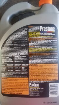

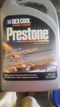

What is the best way to get all the orange out. Since you cannot use a hose to flush.
I previously used prestone GM decool approved. Don't remember flushing before.
I have to buy some distilled water from Walmart like 6 gallons.
Mooseman
25,403
Ottawa, ON
It's probably the same. They can't "call" it Dexcool because it's proprietary to ACDelco but can say it's "compatible" to it.

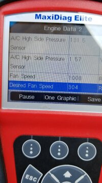

So I drove the car with AC today and noticed some differences. The temp did not go past 201. At idle it was oscillating 198,199 to 201. On the freeway 196,198. The fan though shows different readings than the cheaper equivalent one.
Desired speed is always at 300to 400 but Fan speed goes from 450 to 1000. I cannot feel that though. I never got those readings with the old fan. Not at 201⁰. I will upload a video showing the fan speed driving on the streets from warm up at idle. You can compare with the other videos on Dropbox.
Haven't been uphill yet.
My guess would be the rush of air through the radiator when driving at speed, is contributing to the fan spinning, in addition to the bit of residual friction from the clutch.
Oh this AC fan is really tight cannot spin it freely by hand like the other one. The air has nothing to do with it. This is all belt driven and some computer driven. The other fans were cheap ones and the belt did not spin them properly too much free play. It's clear.
But I have to drive it on a hotter day. Today it was 82⁰ only and on flat land it did not go beyond 201⁰. On the little
But steel hill I went it took it up to 207⁰. Again all very different than before. I hope it stays this way.
