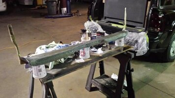

Got a little more progress made on my trim panels. This one is the hardest because curves and contours. Fiberglassing on a Friday night, I'm living the dream!

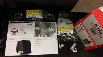

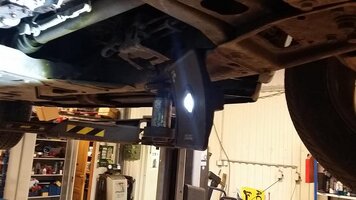

Ok so while the TB is thawing I thought I'll give you guys a sneak preview on today event with my TB.
Replace trans fluid and filter, the nice part of working in a shop is that you have both style filter if you don't know which one is installed.
Replacing license plate bulb harness
Installing new license plate cover glass
Installing a click on bracket for my cell phone, no screw holes in the dash I like that

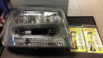

And if I get the time I'll also going to reseal my RH headlamp

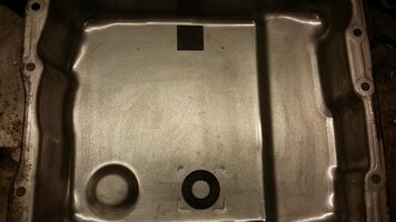

Transmission done, as you can see on the pictures. You should get one of those rechargeable LED lights that are in the picture, those are awesome lights.
Factory transmissions have a thin square magnet inside the pan, I found a TSB were they say that you should replace the square magnet with 2 round ones. I only had 1 round one at the shop so I thought I'll use the square one instead of another round one. I put the square one on the opposite side from factory marking and the round one inside the square marking on the pan. The reason is that on the RH side there is not much room between the pan and the filter so I'm not sure the thicker round magnet would fit on that side (the thin magnet is thin enough to fit between the filter and pan).
Finally install the new gasket and secure it with 4 bolts and you'r ready to install the pan. Of course I put a new filter on it first but got no picture of that.

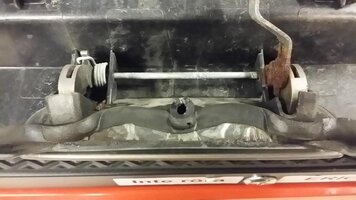

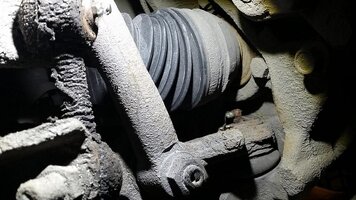

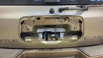

Check point more stuff, greased front end - well the few fitting I could find.

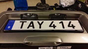

Replaced license plate wire harness due to one bulb socket was corroded to beyond repair. New harness, new covers and nice new screws.
One "what ever it's called" broke when removed but we have special glue for plastic here at work so I fixed it.

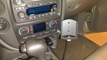

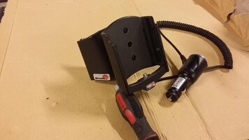

Cell phone holder installed - check!
Brodit also have a holder that snap in up top of dashboard but that one will cover one of the vents,I don't want my vents covered.
I have the one that snaps in at the center vents. Even with my Note 2, it doesn't really cover the vents much, unless you are firing the air stream towards the back seats. As long as they are aimed at the front passengers, it's all good. :thumbsup:
You've definitely been busy. Will be time for a few beers when you get everything done. :yes:

swede said:
Really Blckshdw??
lol, well if you TRY to block the vent, then sure... I installed mine in the middle. Left vent still blows nicely on my face when I need it, never have to turn the blower higher than 2 in the summer.
Passenger side is completely unobstructed.
Sorry but I don't like it, I wish I did but don't
It's all good, different strokes for different folks.
I wanted something that sat up high, but not on the windshield so I could put my sunshade up quickly and easily. I had tried a few other vent mounts, but they shook off when going over speed bumps, or entering driveways that had curbs at the entries. This one's been solid as a JBwelded rock! :biggrin:
Yes I installed mine without the double sided tape and it's like glued on there

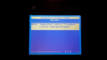

Next mission was to try to recalibrate the aux hvac temp door. No dice. This code pops right back up after clearing. Not really a necessity to fix since the front hvac warms the truck enough. I did some googling and found that the aux hvac module is the tahoes version of the ignition switch guess in the trailblazers.

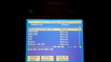

Since I'm still learning the Tahoe I did a module scan to see what all this thing has. 14 modules of fun. In auto hvac there is a section for aux hvac so it's almost like they said "yo dog we heard you like modules so we put modules in your modules so you can module while you module". Thanks GM for making that setup so intuitive, I always look for modules in other modules. :nono:

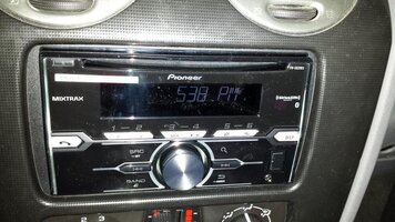

Installed the Pioneer FH-X820BS and GMOS-01. Finally have a CD player again. Chimes are different but work. Got the radio's custom color display for the key and accent lights to reasonably match the Voy's light teal color.
The radio has Bluetooth so I need to install the included microphone. I don't think putting it on the visor will work out in the long run.
