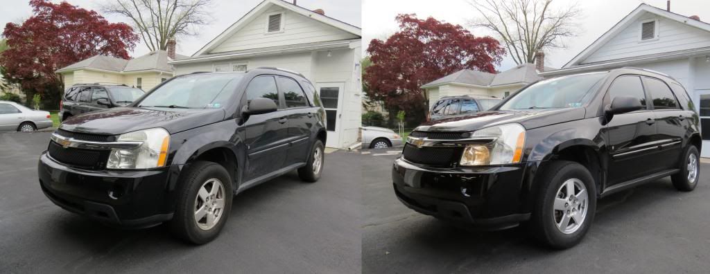

What a day on this one. Customer was ok with using an AIO on the paint since its a daily driver that will probably see a car was sooner than later. Just to add some more protection I added optimum spray was on top. I was very surprised how well Optimum Poli-Seal did on this suv, especially since its black.
