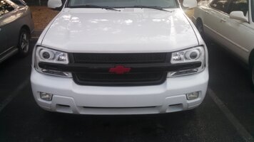

You got any pics of your demon eyes lit up on the TB?
No good demon eye pics. I had the halos set to run along with them as DRLs, and they looked good in person, but the halos were so bright, that they washed out the demon eyes in pics. Probably why it took me so long to realize the strips weren't working right.
The silicone wasn't the issue, all it did was get baked into a hard shell. As you can see, it was still transparent. LEDs don't like heat, it causes them to have a shortened lifespan. The brown bits you see are the white casing of the LEDs, THAT part is burnt.
From up close, or at night, they were visible. I didn't paint my shields though, I'm sure that had a little to do with it. Because of the angles, and lack of paint, the blue wasn't super bright, and the halos did overpower them when you stood at a distance. :twocents:

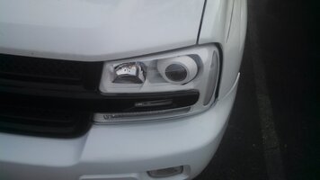

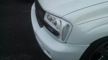

A little test fit teaser. The other lights they're going in are brand new so no nasty yellow tint. The light output is already like night and day with projectors vs. No projectors. My turn signal lense broke so when the new ones come apart I'll take care of that.
Looks good. For a second I thought you'd blacked out the high beam bowl but it looks like the bowls aren't even in there.
No I did black out high beam bowl lol. Both bowls are there. It was just a quick mock up with the stock lights I had. I rarely use my high beams, my projectors are bi-xenon, and I'm more then likely adding led pods for stock high beam bowl.
