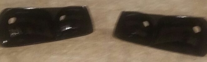

So I figured I'd chime in on this started my retrofit about a week ago. Got my stock headlights cracked apart after some trial and error. Then proceeded to paint my hi/low housing as well as my turn signal housing. I've chosen to go with mini h1s for my retrofit do to it being my first retro and the simplicity of the h1s installation. Still have multiple coats to lay down on the housings. I chose to paint and mod the stock housings so all I had to do was switch everything over to my new headlights and tweak them. I made my clear corner lense tonight. Still waiting on my projectors to come in as well as a few other small things.uploadfromtaptalk1424219158426.png
Painted the grey trim matte white to match my grill. And a picture of the hi/low housing after a few more coats of paint.
