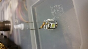

I forgot to mention earlier that this also fixed the problem of the lights being dim when using the map light. Now they function as normal lights. I only did this to the front passenger light because it was the end of the line. But it may work if you put one in any of the sockets.
This had come up before and I was not aware if a solution had been discussed yet.
I had brought up the resistor once or twice and I think Carlton did too but none of us ever tried it that I know of. Since you've been a good little Guinea pig we all know it works now. :wink:
I'll try to get around to trying it in a couple weeks. :tiphat:

I am using, and I know a lot of others are using, the 24 SMD panels. Do you believe that if we put a 680 ohm resistor on the negative (?) side that it would make the lights work as normal? Do you have LEDs in your visor mirror lights? If yes, did it have any affect?

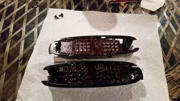

Remember when I said I was playing with nightshades?

At least you won't have to worry about the lights being too bright... Assuming that was your goal
Reactions: mcsteven
Yes it was. They were way too bright. Now they are only about 10% brighter then stock. you couldn't tell the rear windows were tinted at night lol.
:duh: You coulda just used less LEDs you know. If I didn't know about the reduction, I wouldn't have banned you for it. :raspberry:
They didn't seem that bright on the test bench in the garage that was well lit. :raspberry: But at 11 at night when someone opens the door it was like day time. Too much light...

I do. But it needs to be installed as a load resistor. (From positive to neg)
Ok - got it. I'm pretty sure I can solder right handed. Left (dominant hand) is pretty much hopeless.

It is a tight squeeze I had to have it in just the right spot to fit the base back on. You could also probably drop the light from the roof and solder it on the top somewhere or tap it into the wires.
I was glad to fix that problem :yes:
Not sure if this was to my inquiry or someone else's note. I'm using the 24 SMD 5630 boards. I don't know if you've seen them up close but I'm certain you can picture it. It's the board, goes out to positive and negative wire, out to a small connector, and that connector goes to the fitting specific adapter.
