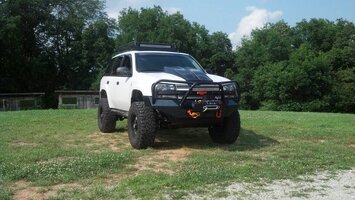

That's the smaller bumper one
Reactions: mcsteven
How much? From who? From where? Manufacturer? Details, details! :inquiringminds:
Reactions: Aarkon

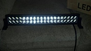

32 in rack.
21 on bumper.
Amazon...Epistar bars. Seem good n reviews were good online and from local guys.
Combo lights w flo on and spot pattern. 120 watts for small one and 180 on bigger.
