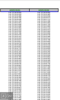

I looked at some of the logs and it looks like when the engine is up to temp, the downstream settles around .7-.8 volts and that's kinda high....it's a rich condition and likely shows inefficiency of the cat. Are you getting a code for the downstream sensor or a catalytic converter code?
Not saying the engine is running rich, but the cat isn't burning off what it needs to. Based on what your engine looks like inside, it could be crud from the crankcase and/or could be a partially clogged cat.
Do you have access to an infrared temp gun? I would shoot the temp at the inlet to the cat, not on the heat shield, but on the exhaust pipe right where it begins to flare out just prior to entering the cat. Then check the temp at the same point after the cat, right where the pipe starts to get smaller. You should see at least a 100 deg increase, generally more.
Drive the car until the temp needle sits straight up, if you can see the downstream data wait until it stabilizes then drive it for a mile or so. Then get out and check the temps.
Check the temp before, at the cat if possible, then after....record the results.

Looking at the Powertrain data, I see when your load is 100% and the accel pedal angle is high, your MAP readings are maxing out at around 14 and I believe that's still kinda low. I will compare mine tomorrow and report back but I want to say mine were repeatedly near 20 or higher......not sure but I will confirm that tomorrow.
If that's the case then that could be a major contributor to your low city mileage.

one thing ive notice is the the fuel trims seem off

also here is a old one but it shows the post cat o2 and the fuel/air ratio when f/a goes to 13 the o2 goes to .40-50mv
https://www.dropbox.com/s/6qy6ycm63zf2195/Powertrain%202014_09_14%2014_14_08.xls?dl=0
