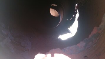

Ok I got around to check the muffler and it's original it's welded at the back. Could the original muffler be bad inside? I'm going to put the endoscope camera through the tail pipe tomorrow and take a look
