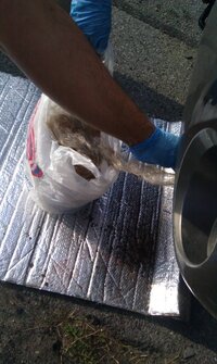

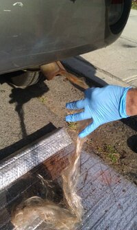

Well I don't know how to put it but my car ate a blond uploadfromtaptalk1410131340084.jpguploadfromtaptalk1410131468736.jpg
So yea I put the 44k and filled up then went to siphon some fuel to use for the Tec but I couldn't so I gave up and decided to floor it either way it didn't feel like it wanted to rev, so on the second pass coming back I pushed it again and it just stood at 5k and didn't want to go and then something popped and sounded like it depressurized so I thought it was a coolant line or the rusty trans cooler line but when I pulled over there was nothing out of place so I drove it some more and checked again twice on the second check I went to check the tail pipe and saw some "hair" coming out so after I got home we pulled all of it out "it filled two bags" then I took it for a drive again and it seemed to rev much more and drive better also it sounds better now that it has a bit of rumble pop on revving so I'm going to see if I cut it off tomorrow also with highway driving it went from 9.1 to 10.4
Well the 44K takes some time to work, usually after a tank of driving. However it seems that your resonator is coming apart inside and a restricted exhaust will surely rob you.
Your truck's way of telling you to cut the can homie!! :deal:

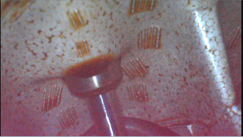

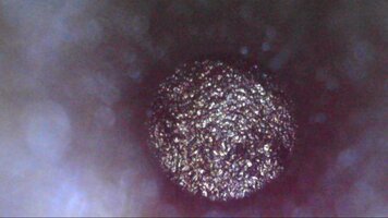

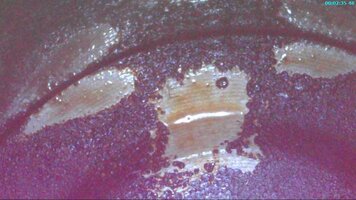

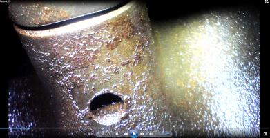

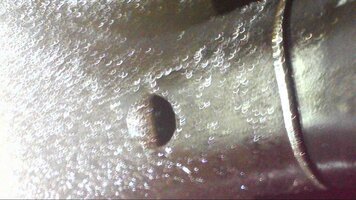

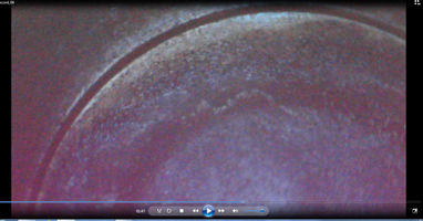

ok thought i should give an update so far i haven't went through the tank of 44k yet but im going to have to fill up since i have to go on a trip so this is also a good time to check mpg and maybe do some water cleaning again after the long trip. i got around to taking off the cpas and a spark plug today and using the endoscope i recently got. here are some pics and the next post will have more pics and video links
picture 1 clean spot on cylinder 2
picture 2 inside pcv intake (valve cover)
picture 3 same thing as #2 just different quality
picture 4 dirty air hose port (pcv vacuum)
picture 5 same thing just different quality
picture 6 intake valves
picture 7 another pic of #2 piston

short vid of piston low quality https://www.youtube.com/watch?v=bLAR6Ua801k&feature=youtu.be
long vid of piston high quality https://www.youtube.com/watch?v=bjvWL9MsJMY&feature=youtu.be
valves https://www.youtube.com/watch?v=n6V0ovSWa0A&feature=youtu.be
