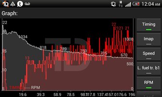

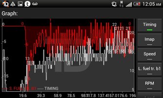

Here's a video of driving after about 5 miles of warm up. I will get another with MAP but it stays pretty much in the 500's with a light load. After my first stop the road somewhat went on a downgrade and there wasn't much fuel in the fire so to speak. I think my cat is getting worn since the warm up takes a little longer but at a highway cruise it does it's job.
It's hard to measure the efficiency at idle, it will cool off a little and the numbers will creep up a little. Best is to test it at a good highway cruise.

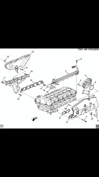

http://www.gmpartseast.com/diagrams/large/56S/air-intake-system-ts0323501.png
Number 8 is the only hose I know of where exactly is the one you are talking of?
Also as far as I know there is just one hose that pulls crankcase gasses out and that is the short fat one. Also why wouldn't there be smoke coming from there? The hose is to vent out gasses which would be the smoke I see.
The air goes from the air filter into the resonator, then exits the bottom of resonator through that short fat hose into valve cover. Then into crankcase and back into intake just above valves.
Between the number 3 and 4 intake runner there's a molded vacuum hose. This pulls air from crankcase into intake.
Number 6 in pic if the pic will download from my phone.

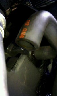

Well the hose looks good from the outside I really dont want to take it off since its in a bad spot. Dose that hose normally go bad?
You should not be blowing smoke from the other end. That hose supplies vacuum, I would start there. Don't crank it off with pliers, turn it and pry gently. It's a dealer item
Ok well I will try to take it off idk why they put a clamp on the hardest side when there's not alot of space to get to it
Any tips on how to get off that clamp?
Lol...the clamp should lock in place when fully opened. I take some silicone or light dab of oil and that helps.

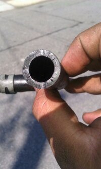

I already spayed it with wd-40 the problem is that I can barley fit pliers in there
Ok I found my needle nose channel locks and got it out
Would you happen to have a part #
Ok the # is 575660 for the hose and it comes with a new clamp for $9

Chances are it's not clogged, stick in a screwdriver gently and feel for resistance, thus determining whether there is or not gunk in there... I'm thinking if a PCM flash doesn't fix your problem, you might have internal damage...
Well I did just finished it and did both I stuck a 1/4" screwdriver in there and sprayed tb cleaner

I recorded some live data and will post later also I will try both of what you said later since neighbors started cutting grass and I won't be going out until.they finish since the winds blowing that stuff everywhere
