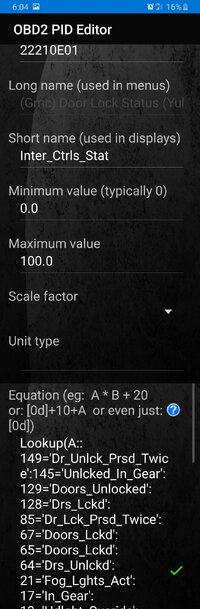

Very interesting indeed. As a return to the information you have shared this is what I've had for some time. I believe this works for my 03 Yukon. One of the reasons I believe this is monitored is for example when you put the vehicle in drive this locks the doors and if the back hatch or any access is open normally you get a warning chime. This also probably works with the "Passenger Presence System" for the airbag system and other systems. This is not something I achieved from another source this was hard earned. Don't know if anyone else has discovered this particular information but figured you would find this useful TJBaker57.
Well I have not seen this elsewhere. What you have here is another PID for the BCM which is a bitmapped representation of the status of the door ajar switches.
bit 0 = drivers door
bit 1 = pass. door
bit 2 = Driver rear door
bit 3 = Pass. rear door
bit 4 plus bit 5 = rear hacth OR glass
The same PID works for the trailblazer however for this vehicle the rear glass and rear hatch are separate, bit 4 being the glass and bit 5 being the hatch.

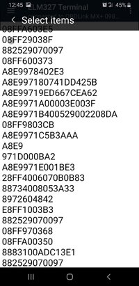

So with a bit of editing I was able to use data from your screenshots in the spreadsheet. Your Yukon has a couple of nodes the spreadsheet doesn't have yet as they are not in the Trailblazer. $A6 and $9A at least so the source name might not be correct but the Target name is correct. I see no mirrors here. The black background cells are merely network heartbeat messages, modules confirming they are awake. the 25 29 97 in tan is something to do with the wheels. I haven't figured that one out yet but know it is not a wheel speed. I do not have any navigation in either truck so that's a mystery, maybe coordinates, direction of travel, that sort of thing? The FF 40 06 seen first at spreadsheet row 16 is 3 bytes of bitmapped status in columns M, N & O. The value in M tells me your key is in the run position. (6 is acc, 8 is start, 3 is off and there actually is a position between off and acc, at least confirmed on the trailblazer where that first click before the acc position powers up at least 2 circuits, fuse #50 and #47) I think this is done to give the PCM and BCM a headstart before the ACC position is reached. Moving on, 2 entries to target address (Primary ID pair) $73 & $72 are the BCM reporting the current voltage to the IPC. Your value is $053A which equates to 13.38 VDC. The next new thing seen is at spreadsheet row 23 (leftmost in pic) and this is the PCM reporting a fuel system value. While I cannot pin it down yet I have a hunch it is fuel used to be added to the fuel used variable in the IPC. On longer sessions in my Yukon this value has risen up to the max of $FF then restarts at $00. The only guess I could make is a consumption count of some item and the Primary ID pair is designated as fuel system. The next new item is at spreadsheet row 29 and is the PCM reporting engine oil pressure, Primary ID $4B, Secondary ID of $11 (as seen in SAE 2178 section 4). Your value there is $3A. SAE 2178 sec 2 gives us the scaling of 1 bit=4 kPaG so a little math yields 33.65 PSI. The rest seems repetition of previous lines for the most part.
I would add the command ATS1 to your logging initiation string to keep the bytes separated and far easier to read. What are you using to record?

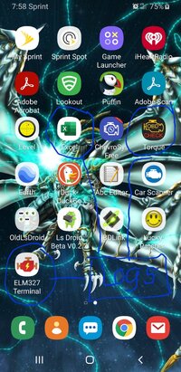

Interesting indeed, well thought-out and well presented. This helps me tremendously as I hope it further helps you. I noticed the ID pairs. But this was done with about 2 minutes time provided. All I could do was screenshot. I'll take your suggestion of ATS1. For some reason it seemed like I knew that command but it got lost in Daily duties and time. I have struggled with Sheets for data logging in terms of format. Although I can produce a proper spreadsheet of a future data log as I will include this so you won't have to do any footwork from an image. The idea is to refresh what I already know and delve deep into this. I love to learn and I love a challenge and this intrigues me. Another point of learning this is I expect both of my vehicles to go into hyper mile. I may do two separate logs with the first one setting a header just for my BCM which is where my vehicle can get very interesting as I have flex fuel. Second to that, I may try a short broadcast header. So I'll have more data to share and I'll try to interpret everything as best I can before I submit that on this page. Thank you very much. I usually learn very quickly and as we converse over this data I am learning more.
Edit: was easier to screenshot and circle the combination. I've used other apps in the past.

, G in my spreadsheet pics where the W, Q, and C bits are listed?
I could likely do a lookup column that would list the message operation. I had considered that but thought the sheet was getting too wide but no I am thinking maybe to go ahead with that idea. Might make the sheet more easily followed.
My spreadsheets are Google sheets so they are online and shareable as well as easily copied so as this progresses I will have links to them. They can be viewed in the Sheets app or simply seen in HTML.
I did notice the binary. Magic is in the details. So the lookup would be welcomed in my mind.
Might I suggest you have a look at "Bluetooth Serial Terminal" by Kai Morich on the Google Play Store.
What drew me this app is:
Supports up to 35 macros such that you can write out your command strings and have them ready to send at the push of a button.
Save your data either straight to clipboard or a timed & dated text file.
Very simple setup, I just set a line delay of 1000 ms, a between character delay of 5 ms, enabled timestamps, pick a directory for log file saving and I may have needed to set the end of line character(s).
My biggest issue in doing any of this is an apparently inherent instability of Android Bluetooth.

I noticed a potentially useful bit here....
Recording during startup captures the voltage drop seen by the BCM. In this filtered view it can be seen at row 2 my voltage drops to 8.21 volts! Happens for a second maybe and way too fast to be seen accurately just watching the dashboard. I suppose a fancy multimeter could capture min and max values. But Hey! I'm getting all this with a $12 adapter!
Thus far I have resolved or at least identified the following values in the class 2 serial data:
*Front Wheel Speed
*Vehicle Speed
*Odometer
*Incremental Odometer??
*Oil Pressure (as faked by PCM)
*Charging Volts DC
*AC High Pressure
*Rear Blower Speed
*Rear Washer On/Off
*Engine Air Intake Temperature
*Outside Temperature
*Engine Torque
*An unresolved incremental value for fuel system (possibly fuel used?)
*Fuel Level as percent
*Engine Coolant Temperature
*Engine RPM
*Transmission Shift position from PCM (PRND321)
