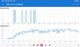

Jumping back a bit, you found you have some misfires going on. I decided to have a look at my own under similar operational conditions.
I drove a few miles to Dollar General, grabbed a couple items and drove back. similar mileage.
Here is a screenshot of total current misfires against engine coolant temperature.
Look at my #2 cylinder, it's pretty bad at idle. The scale auto adjusted to 0-100.
I don't like how the sensors record a misfire though. I bet if I hit the block with a hammer while it was running the ECM would record missing and knocking LOL
But, it's just a piece of a bigger picture.
Agreed. You have a concern there, but I noticed it did not misfire again after the initial event when not yet warmed up.
Now when I have had enough to cause a flashing check engine light there was more like 12000 or more misfires registered.
ps/edit: There is also a PID/sensor for ALL current misfires. This will sum up all the cylinder misfires over a short period.
Look at the very end of cylinder 2 and you can see it started to miss again when I parked.
