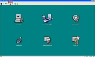

Then after you first Click on the TIS2000 Desktop Icon and open TIS2000 Software to the Main Screen... Before you Click on this Tech 2 View Icon...
.... Select the Configuration Tab (Highlighted inside the Red Rectangle of the Attached Image) and look there for the I/O Management (Input - Output). Then select either the Tech 2 Option or the Pass-Thru Option from the Menu. First High-Light the Tech 2 Option (White Text on a Dark Blue Border) and then Select the Properties Tab on the Right Side of the Menu. From there, you can Select your COM1-4 Port and Baud Rate. Use the 115200 Setting :
If you then select the Tech 2 View Option on the Laptop Screen, after turning on the Tech 2 Scanner, once it finishes its Boot Up Self-Diagnosis, you can use your Mouse to select any of the Tech 2 View Keypad Buttons or Function Keys (F1-F4, etc.) BOTH screens for the Tech 2 and the laptop should simultaneously change. If these actions work either from the Tech 2 itself or from the Laptop Tech 2 View Mouse on Keys Selection actions, then you should have Good Hardware Connections and Good Bi-Directional COM Port Communications. The SPS Activities should work after following these steps.

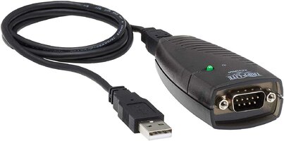

Ok, so I got a chance to try it out. I followed all directions, i got the Tech 2 View to work, i can control the screen on the Tech 2 with the Laptop. When i go to use SPS, same thing is happening as before.
"E665: The communication could not be established with the diagnostic tool! Please ensure proper connection!"
i get this after i directly go from the viewer to SPS.
Myabe its the prolific usb to serial adapter?
Yes
As per @Mooseman...Yes... The Beez-Kneez...
Alright, I'll get one coming in the mail and report back

OK, I didn't have a chance to do the actual programming, but i got the new serial adapter all set up, and its now talking with the tech2 no comm errors, it let me keep going through the process of SPS, So im going to call that a WIN my next day off is Thursday, so I will actually try to program it then, but the correct adapter was the ticket, and the correct version/properly cracked tis2000 program.
Thanks for all the help I received, I am on a few forums, and this place has been one of the most helpful with out any negatives, or being given any grief for not knowing what I am doing.

(3) What Brand-Make-Model is your USB-Serial Port Adapter.
If it is NOT THIS One... You should consider getting one:
Tripp-Lite KeySpan Model# USA-19HS
