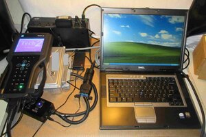

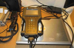

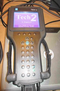

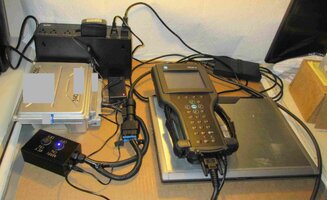

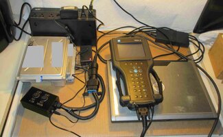

Okay… While setting up all of the various TIS2000 “Hard Ware” Parts and Pieces on an insulated Pad on the top of my Stove (of all places) ...I ran into a particularly troublesome and annoying problem when attempting to “Clone” my New Donor GM P01 PCM-ECM Unit via the combination of the UPS Power Supply, The Dell Precision M65 Laptop, The PCM as mentioned...along with its unique “Power-Serial Data-OBD2” Cable and of course… My Redoubtable “GYMKO” Tech 2 Scanner. As you can see from the attached images... everything necessary was pretty crammed and cramped in that space in order to gather this Gear all together under my watchful eye. It gives a Whole New Meaning to the Expression… “STOVE TOP STUFFING”.
Anyhow… as you can see from the numerous Screen Prints... Everything was going along bouncing and beautifully well… right up until the “Moment of Truth” arrived when I guided my Mouse over the SPS Programming Icon on the Dell Desktop and observed the “Ban Hammer” come down as the Dreaded “E6**” Message that prevented me making any further progress. Many of you already know that I am “Irrationally Superstitious” of Certain Numbers… so you’ll have to draw your own conclusions as to what those *s conceal of it’s “Infernal Identity”...and the reactions I have when things like this happen that give credence to my concerns about such "Numbers". All I can say is… this DID happen and now I’m faced with the dilemma of trying to work through and Figure Out a Decent Fix... as I'd rather like to avoid "Bricking" a Nice New, Virgin PCM-ECM in the offing.
Now, I don’t know whether this happened because I installed the “Glowing” USB HWK (Hard Ware Key) prematurely… or whether or not that there was a problem with the TIS2000 Installation or NOT. Or… Was it because I had AVAST AVSW Running and a FIREWALL invoked? I don’t know... But things went downhill pretty fast from there on as soon as I decided to “uninstall” the TIS2000 Suite. This is because ... as it turns out… I was unable to locate any “Uninstall” Application anywhere in the entire “Mouse’s Maze” that made up the TIS2000 SW that accompanies every single Windows Based Application I've ever worked on, going back to the Early 8086-8088 Programming Days. Yet...’neath the Skin of this Windows XP Professional OS…. A TIS2000 COSIDS Application had been placed there and in hiding and it was STILL busily working away and doing... God Only Knows What Kind of Mischief…!

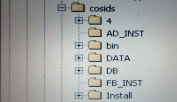

Ok guys, I had some sort of screw up. I installed it, the tis 2000 wouldnt work, indefinate loading, causing the comp to freeze, so i uninstalled everything, start over. well i go back to do the dongle install, and I have no BIN folder i did before, but not now.
There is only 4 things in the folder now. a folder labeled "INSTALL", "cosids.cfg", "LogTbi.txt", "LogUpd1.txt" that's it, I didn't delete anything that I'm aware of.
The files from the dongle folder are still in the c:\WINDOWS\system32

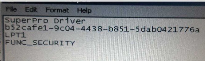

Okay... Usually... There is an Updated (3) Disc Set that follows an Installation pattern with these Orders of Operation:
(1) The FIRST Disc gets installed. Then immediately AFTER Starting the TIS2000 Program from the Desk Top Icon... the TIS2000 Software prompts the User to "Install the Second (Update) CD"... into the Disc Drive.
(2) After Swapping the FIRST Disc for the SECOND Disc and allowing the Updating Procedures to proceed, it will take a few minutes to Wipe Out the Old R-Base Files and then install the Very Latest Software Updates. If you get any kind of Error Message on Screen...Ignore it and Press the <E> Enter Key. The SECOND CD Will Continue to Update.
(3) Then the User removes the Second Disc and WITHOUT FURTHER PROMPTING ...after installing the THIRD Disc into the Drive, The User should open the Directory on it and look for the "Dongle Crack Installation Instructions". There will only be Two Files on the THIRD Disc (a) The Crack Install Instructions and (b) The LATEST Dongle Crack called:
SuperPro.DLL
(4) The idea is for you to FIRST Locate the Old SuperPro.DLL as shown in the above Screen Prints along with its associated Text Identity file just called SuperPro in the Cosids/BIN Sub Directory and then... DELETE THEM BOTH. DO NOT COPY OVER THOSE FILES. Then just Copy ONLY the NEW SuperPro.DLL File from the THIRD Disc... right over into the Windows TIS2000 Cosids/BIN Sub-Directory.
NOTE:
If the "Dongle Crack" Instructions on the THIRD Disc directs you to Install the New SuperPro.DLL into OTHER Sub-Directories ...then do it THAT way. The Important thing is to locate EXACTLY where any other copies of the Old SuperPro.DLL might be residing ...and Get Rid of them ALL ...FIRST...THEN Copy over the New Version to the correct Directory/Sub-Directory 'as Instructed'.
(5) Then Close all Sub-Directories and Click on the TIS2000 Desktop Icon. The Program should RUN and ...assuming that you have already Hooked Up your Tech 2 Scanner properly for Serial Port Communications ... The TIS2000 App "Dongle Crack" (SuperPro.DLL) should be able to give you access to the SPS Programming and other Options for TIS2000 Software to work through your Tech 2 Scanner. There will be No Further Need for the PHYSICAL USB "HWK "(Hard Ware Key) AKA "Dongle"...so if you HAVE One Handy... DO NOT PLUG IT IN.

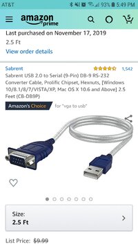

I checked which usb ports were what through the hardware device manager made sure the right port is where i had the serial adapter plugged in, but still no communication between pc and tech 2.
Anyone have a direction to point me in? would be greatly appreciated, as I do not have enough hair to pull out lol
Are you using a USB to serial port adapter? If so, the Tech 2 is sensitive to which type it can communicate with (TI or FTDI are good, Prolific is a no-go).
Looks like the one I bought has a prolific chip set, so I guess that solves that.....I'll look at one of the other ones
