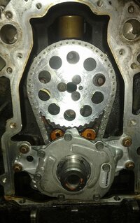

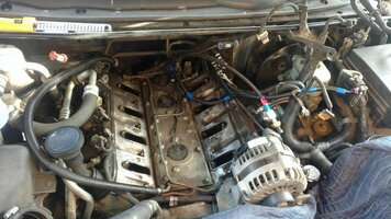

-Here's the big one. I was getting the dreaded "zero oil pressure at idle" issue. I opted to change the oil pump. This requires stripping down the nose of the truck. A lift is required. I obtained a Schumann's racing pump, ported, ball relief valve, O-ringed outlet along with a Rollmaster billet timing set, new GM ballancer, ARP crank bolt and a gasket & seal set. This job was a TON of work but very worth it. I now have 45 PSI at hot idle and 60 at highway speed, 70 PSI above 3,500 RPM. I believe the cause of the problem was a broken oil pump inlet O-ring. This engine is ready for another 280,000 thousand miles!

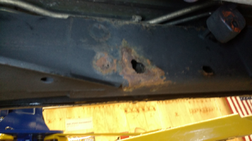

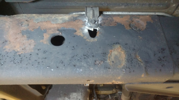

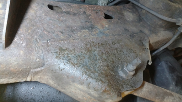

I’m starting to notice some rust on the frame. The frame joint under the passenger seat has a hole through it. I’m gonna have some plates welded on. Other areas have some rust, including the rear springs. I’ll be ordering springs.

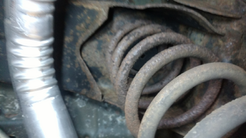

The body bushing washers are starting to rust. The one under the passenger door hinge is gone. I gotta work on addressing this problem.
The engine & trans work great but I’m concerned about the frame rust. And the tailgate bottom edges are rotting. The rest of the body is rust free.
