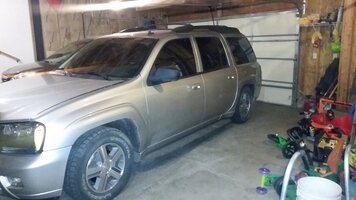

I had the whole shabang on my 06 envoy.
That looks really good. My main concern is bouncing the kids outta the third row like back in the day on the school bus. Lol. If i had a swb i would wanna go as low as that.

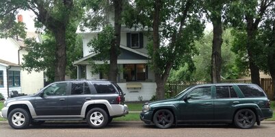

I wanted to wash and detail and stage them somewhere cool but that just isn't going to happen so here they are finished...for now. The green one is so low the splash guards scrape speed bumps! That takes me back to my youth...
