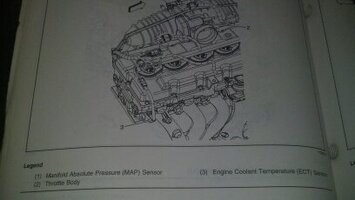

Then why does it say in the 2006 manual that it goes behind the alternator? Which is located on the drivers side.

That's really weird. We downloaded the 06 chilton manual and it shows it on the driver side, behind the ALT like the rest of our trucks. I wonder where we downloaded the manual from and maybe I can e-mail the person with the diagram, and let them know that it is supposed to be behind the engine. Not arguing whatsoever...just confused, as we looked at about 10 different diagrams last night for Lee, and they all said the same.

Hmmm....That's not what my manual says lol
