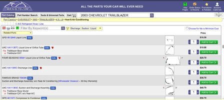

The Fill (Low Side) (Blue) Port is on the outside upper portion of the Accumulator near the Passenger Side Firewall under a Black Sealing Cap. If that thing is now FUBAR'd... To REPLACE that Entire Liquid Line... Visit Rock Auto and Pick from THIS List according to your Sub-Model SUV:

It’s a bolt-on port. I’m thinking it got attached very tightly at the factory. Also OEM rubber ball valve. Replacement will be schrader. And into the bargain, rear AC get a more involved evap tube (grainy schematic item #9).
The RockAuto photo is a non-rear AC tube, and it has that coupling at its middle, my extant tube instead has this block with those two tubes exiting.
I’m musing that perhaps I could get the RockAuto tube, and graft it onto mine with one of those splice kits, somewhere near the middle of the air box. Sure seems it perhaps might be a simpler task if doable. Thoughts?

The RA line is for non-rear AC. Seems all the available lines are. The shop guy was from the very first not at all optimistic regarding getting this line. A very unfortunate event, this.
This photo is from TrailVoy when an owner had the same stuck port, and broke the line. The GM part number from that post crossed to several RA units (UAC HA111397C Liquid Line w/ Orifice Tube) (FOUR SEASONS 65641 Liquid Line w/ Orifice Tube) (GPD 4812946 Liquid Line), and napa (Part #: TEM 212048) came back to the non-rear AC line. AutoZone? Same. I’ve been looking for salvage and there are some spread about the country. Here’s what I’m going to do—
—Dorman-splice either my pipe after I sever it somewhere behind the air box and hopefully get that port off using a vise&cheater bar, or get the RA non-rear pipe and graft the donor ported portion.
This has to be doable. Be a whole heap easier than replacing the entire line. I’m seeing many variations on this theme on yt.
