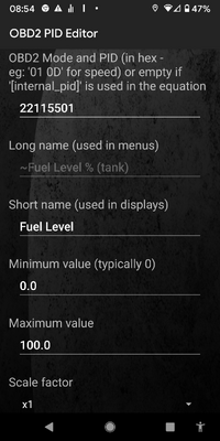

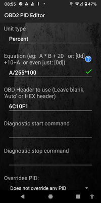

So having looked at this again.... and checking my own gauge... I came to realize I just about never pay much attention to the gauge beyond "full,,, around half,,, getting low"!! I just don't. I know these gauges are not designed for a high level of precision. They just aren't.
I have had mine since 2010 and I record every fillup in a spreadsheet (it allows far more possibilities than any app ever will). So I have a good handle on how far a tank will go and I watch the trip miles.
All that aside... if one is interested in a PID for fuel tank level here is what I use for a 2002 with 4.2 LL8.

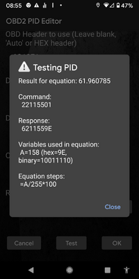

View attachment 100569View attachment 100570
I appreciate that. What app is this?

The app is Torque Pro but any app that allows for custom PIDs can use these parameters. OBD Fusion, Car Scanner for a couple others.

This isnt working for me somehow.

Since this was posted I had the opportunity to do more research and if I'm right in 2004 they dropped the 1155 PID and instead implemented the equivalent SAE standard PID which is 002F. They kept this in 2005 but then in 2006 went back to the 1155 for that year but then in 2007 changed back again to match the 2005!!
So if you still have that PID definition in Torque Pro go in there and change the "1155" to "002F" and let's see what that gets us.

Forgive me, but I need a little more hand holding than that. Im very tech inclined but never before used a scantool app.
TJBaker57
Aug 16, 2015
2,900
Colorado
Ok, I see in your screenshot back in post #20 on Jun 9 2021 that you had entered the PID setup in Torque Pro as was suggested by me several posts before that at post #14. It did not work for you then.
Assuming you have not deleted the PID you set up back then you can edit that existing entry. The only thing that needs changing is the field "mode and PID". Change it from "22115501" to "22002F01". Save the setup at the bottom of the page.
Do you remember where to go to do this edit?
Tracking. I'll give this a shot.
update:
I doublechecked the form and Im certain I filled it out exactly as you have. Made the change to the mode and pid field and saved it. Readded it to my live data page and it just reads 0.0
