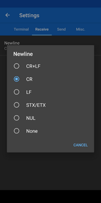

I got it to work, apparently I need to use the OBDLink app first and pair through there. So following your instructions, I’m getting these messages:
You need to adjust the "newline" character setting in the serial terminal app. It will be a bit of trial and error. Looks like these choices...
Even without line breaks I can easily see the PCM, BCM, LGM, PDM, DDM and others sending their awake messages indicating they are alive and well. They send these messages like every 2 seconds.
EDIT: I also see the cluster.
I’ve posted a paste in link with a length of data in it. https://pastebin.com/8v2WvZZQ

CR did the trick. What should I do now?View attachment 108922
So right there I can see many modules sending there awake status. The 3rd byte in eachessage is the address of the module sending the message. Just listing the ones I know straight away... A0 is DDM, A1 is PDM, A2 is LGM, 11 is P M, 40 is BCM, 60 is IPC, 89 is either radio or amp or similar.
All messages in that screen are nothing more than network status messages, the vehicle network is pretty much idle with no real.activity there right now.
We can explore more later but the main focus right now should be getting the imteruption of 12 volt signal on A19 resolved. That absolutely must have that signal of 12 volts at BCM ribbon cable terminal A19 with key in RUN
