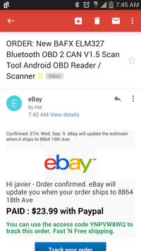

After a whole lot of reading here I decided it was time to pony up and pick up the bafx obd2 scanner. I'm about sick and tired of running to autozone to get my codes reed. And the fact that they won't clear them after I do the repairs sucks balls. uploadfromtaptalk1441281059585.png

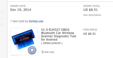

Well... ran into a snag with my eBay cheapo scanner... it works beautifully on can systems, works great on my 2014 express and my 2008 trailblazer, but would not connect to my in laws 2003 hummer h2... had to break out the Ole USB cable for that one.
You sure you're getting power to the OBD port?

Strange. My el cheapo ELM327 works great on my 02 TB. Can you post a pic of it or the eBay listing?

That's the same one I've got. Works well on my 05 EXT, sent one to my dad and works on his 04 Ascender. :twocents:

Mine is like this one. Absolutely no issues.
