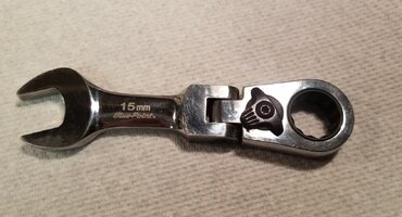

This is my best friend for the lower alternator bolt. Don't have the part number, but the Snap-On man can get it.
If you get backed into the A/C line, just flip the switch....the open end works quick also being stubby.
