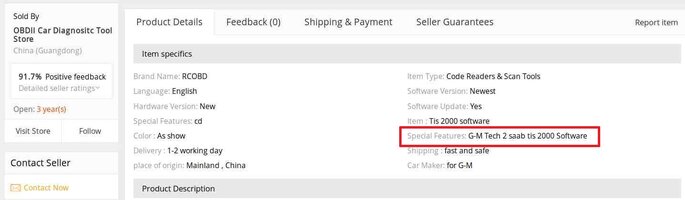

If you look at the screen print that shows the section about half way down the page from your Link listed above... The way the "AliExpress.com Sellers 'avoid any entanglements' is by the hyphenation they place in between the "G" and the "M" as you can see inside of that Red Rectangle... so i'm in agreement with @Mooseman's observation that this USB Dongle SHOULD be the correct one.
