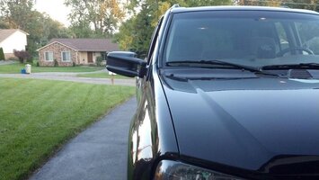

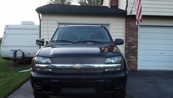

If you want tow mirrors like on the 04-05 GMT 800 trucks they wont be a direct fit due to how the bolt on but I can show you what needs to be done! I have all the functions except for power extending since this was an expensive enough gamble its self. I've been meaning to do an article on how to install them but I keep forgetting but maybe today ill do it.
Here is how mine turned out! There are better pics in the link above.

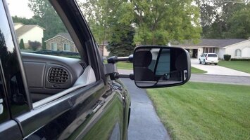

Like previously posted, there are differences in the mounting holes of the Trailblazer and the Silverado, so it took about 45 minutes of monkeying around with a driill and a rotary tool to make it fit just right. So far I've only installed the passenger side mirror because we're going up north this weekend camping and I don't have the time to get the drivers side installed yet.
Also note, my original mirrors are NO power, NO blinkers, NO heat. Totally manual. Turns out there is NO wiring harness in the door for power mirrors, so I'm glad I opted for the manual towing mirrors as well. I would have been really bummed if I spent more for power mirrors then had no wiring to connect them up...
So here's the new mirrors collaped and extended
Compare the old mirror to the new one, collapsed and extended
From the back, collapsed and extended
The difference between the mounting leaves a small gap which I will be finding some rubber trim to make it look like factory again...
