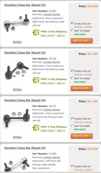

When i go to advance auto's website and search for end links for the TB, why does it show the normal type end link?

Sorry.......what are you asking? Should it show aftermarket ones and all you see are AC Delco OEM style?
Im saying when i search for the end links for a trailblazer(at autozone and advance auto) it shows these end links
This is what I see on Autozone right now for a 2004 Envoy.
That picture you posted is the typical "generic" picture used a lot by cheap, lazy Ebay and Amazon vendors. A parts store that uses generic pictures should STILL give you the correct part when you go in the door.
