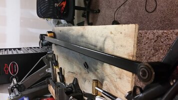

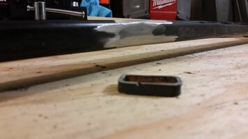

Finally got around to centering my rear axle. I added 3/8" to the bar by cutting out a 12" inches and welding in a 12 3/8 section. It is perfectly centered now and actually handles much better. I didn't think it would make that much of a difference. I just ordered djm 4" drop shocks for the rear. Hellz yeah

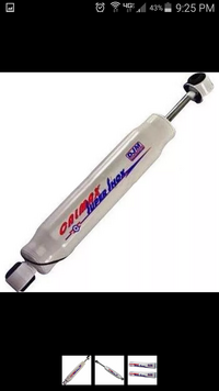

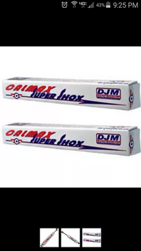

Never even heard of them lol. Hopefully you like them. Djm reminds me of jdm so that itself leaves a foul taste in my mouth lol. Let us know how they go :woot:
