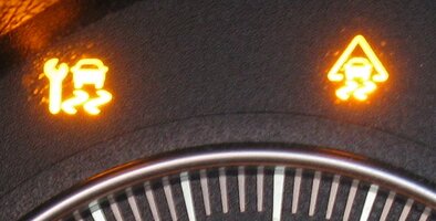

about my Service Stabilitrak lamps turning on only when my steering wheel is turned to full right lock. Clears when engine is restarted with wheel not at full right lock. Seems more and more like the SWPS is worn or corroded at the full right lock position. Will find out when weather warms up and I try replacing the sensor. (p.s. this started intermittently quite some time ago then recently began happening on every trip. I'm at 167,000km)
