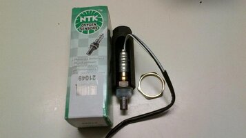

I also recently changed the upstream o2 sensor. I was getting decent mileage on the highway around 19-20 mpg, but after replacing the sensor, and pulling the PCM fuses, I am now down to 14-15 mpg highway.

I was going to find a place to do a back pressure test. I replaced the o2 with an ACDelco. Injector pulses are all normal, transmission shifts good, no dragging on the brakes, new thermostat. I recently took out the CPAS and it was very clean.

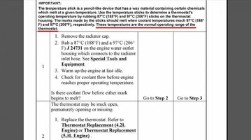

According to the service manual this is normal. The range is 190 - 220F. One should have no reason to believe what someone says the dash gauge should show. A visual inspection like that just isn't in the service manual.
There are multiple different thermostats with different spring rates and opening temps. There are 185, 190, 192, 195F tstats, etc... These thermostats do not all open at 195F. I have boil tested three brands and they all open differently.

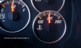

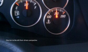

One tick to the left isn't too cold, depends on how you look at it. Anything further definitely, but we can agree the gauge isn't 100%. When mine is around 205-207 it's almost straight up.

The gauge is a good indicator BUT not all the gauges are exactly the same. Mine always has run 1 tick to the left since I got the truck, but does that mean it is actually running too cool? No. There would be no way I could be getting an average of 19 mpg per tank out of my truck if it was running too cool as the computer would be dumping fuel trying to warm it up. Apparently, my needle wasn't put on the shaft exactly right.
If you're having mpg issues and the needle is over by a tick, then I'd take that as a good sign things are too cool. But if everything has been normal and it is one tick left then it is probably just a slightly off gauge. It isn't like these gauges are the most accurate things anyway - 100 to 210 from low to middle point, then 210 to 260 from mid to high? What kind of wonky scale is that? :blinkhuh: definitely not linear, that's for sure.

I agree it can depend on how the needle was mounted, but I also believe these gauges are fairly accurate. For the sake of this thread...can we also agree that there is a constant varying voltage coming from the temp sensor and the gauge moves accordingly? We all drive these almost daily and the needle reads the same when hot, it's not some arbitrary voltage it's an actual thermistor and changes voltage with temp changes. Sending a changing voltage to the ECM then sending a voltage to the cluster.
When the coolant temp rises, the gauge rises,.... not cold, warm, hot, but incrementally. The thermostat according to the service manual is normal when opening from 188-206 deg....195 is fine. One tick to the left is fine, 2 or more is not good. 210 deg is straight up, I don't want my gauge reading 210 when my coolant is 195, I prefer to know what the temp is, especially when it starts getting too hot.
Back to the quote, the odd display is not linear for sure, it's setup like a half-sweep gauge and this is used widely. Helps to monitor changes like when the coolant starts to rise past normal, easier to monitor the smaller increments.
I do believe the gauge inaccuracy is more the needle placement than the gauge itself. You have a good point on the scale and the half-sweep thing.
Chickenhawk said:
One tick to the left is still too cold. The thermostat starts opening at 195 and should keep temps around 200 to 210.
If you changed to a good thermostat, I would suspect the coolant temp sensor. It sits in the coolant stream and functions using an electromechanical circuit, so it stands to reason that they can get lazy after many years in the coolant stream.
This is why we recommend changing both at the same time. If the thermostat is bad, the engine runs cool and starts enriching the mixture when it doesn't need it. The cat runs on a VERY narrow fuel/air ratio and the cat will gradually clog.
If the coolant temp sensor is bad, then the engine is a proper temp but the computer THINKS it is running too cool. The results are exactly the same.
Before you start monkeying around with less-common causes, check out the simplest and likeliest: the coolant temp sensor and the partially clogged cat. Temps should not be 195 when warm; that is the approximate temp at which the thermostat starts to open.
What you are saying about the temp sensor is correct, however his scan is showing 195 being read by the ECM.
I have never seen an engine that is too cold at 195 deg, please show me this engine, it surely isn't an LL8.
195 deg is a normal temp for this motor. When mine is 1 tick to the left, like others, it's at or very near 195. When mine was 2 ticks to the left, it was in the low to mid 180's and was too cold.
If the sensor is reading 195 and the coolant is flowing at 180 then you have an issue with the sensor, this is why the melt test is used. Generally the sensor reads low when bad due to higher resistance in the thermistor.
This is taken from the service manual, if anyone thinks 195 deg is too cold and wants to start changing thermostats then that's on you and you need to take it up with GM.
