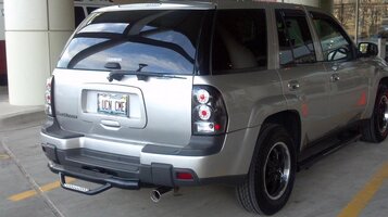

Ok here's some solid information. Mark's 2 1/2" front lift with new bilstein HDs and 2" rear spacers with stock springs and shocks (new bilsteins to come). Chrome Gunner 6 17 X 8 X +25 offset wheels (stock wheels are 17 X 7 X +50 offset). The wheels give an additional 12 mm inside clearance. Cooper Discoverer ATP 265/70 17 tires. No spacers, no cutting, no other mods. About an inch upper ball joint clearance. At most I may have to shave a quarter inch from the lower front bumper but so far no rubbing at all in turns or over bumps. It's close but works.

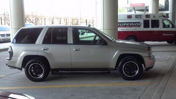

18" Polished MB Gunner 6 w/ 265/60r18 General Grabbers. Suspension is stock. Debated on goin up and/or down and decided i like it just the way it is with these rims and tires.

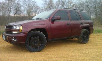

jham;345]MarkMC New Style Lift
3" body lift
BDS Rear
Bilstein HD Front
KMC XD Series Addict 17-9 +18 offset
Nitton Trail Grappler 295/70/17
1.5 Adaptors
Flipped UCA's

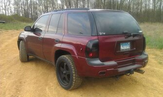

Finally got my new tires fitted to my lifted truck
MarkMc 2.5" Lift Kit
Bilstein HD Shocks
BF Goodrich All-Terrain 265/70/17
1.5" Spacers
American Trench 17's chrome

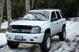

Marks 3" Lift
Marks Wheel Spacers 6x5-6x5
Stock Wheels
265/70-17 General Grabber At2
SkyJacker S97N8030 Rear Shocks
Bilstein Struts F4-BE5-A333-H0
Fliped and Rotated UCA's
