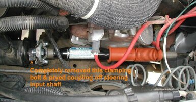

I had some play in the steering. After investigating I found over time the rag joint had some play. It's attached to the lower steering shaft and only replaced as an unit.... expensive.
Anyway I took some pictures of how I replaced the coupling. I don't recall dimensions so you should verify the Dorman 31002 couple has the correct dimensions for the 97.
I drilled and ground off the rivets in the original joint and replaced the coupler with the Dorman 31002 and put back together with 3/8" bolts.
You can see if the lower steering shaft is removed it gives access to the plug with close clearance.
