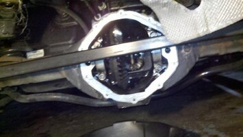

I finally got the rear diff changed. My old 02 had a drain plug and the job took 45 minutes. Removing the spare then the cover make this a 1:45 job. Thanks for the tip on the screws having loctite. I guess the good part is You can use up some paper towels and get most of the grit out of the inside. The downside is since the job is more involved, I'll be tempted to stretch fluid change to 50k v say 30k. We'll see. I bought a spare gasket for $15 online just in case. Pretty cool to see the gearset. This is an 07 Voy with 95k miles. I'm fairly sure the rear diff ewas never changed....
Unless you do a lot of off roading and/or a lot of towing, IMHO, 50k miles is more than enough for diff fluid changes.
