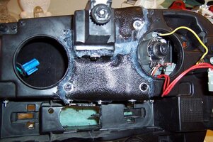

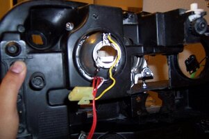

Just throwing my .02 out there... when I did my FX35 retrofit, I used the following alignment method, I thought it went pretty well.. the toughest part was finding a leveled parking lot with a wall... just thought I share this, if other methods aren't working out...
JnC's Mounting Method (with Rotational Adj Capability)
Pic of my projector in place with Upgrade lens from retrofit source removed....
:goodpost: Like a boss!!! Several times when I was doing my alignments, I was trying to think of a way to do exactly what you did. Obviously with the TB lights built the way they are, you wouldn't be able to make any adjustments once they were sealed up. I was trying to think of some kinda worm gear drive accessed from the backside of the headlight, and all other kinds of off the wall stuff.
That's pretty sweet though, would have made things so easy if we could do that with our lights. :yes:
I wish we could have used this method on our retros :frown:
and it also makes it a helluva lot easier to adjust the way you want when you use the centric rings to mount your shrouds...my shrouds screwed on to the back of the projector housing, which made it a PITA
and I wasn't aware of that limitation until I got them in and looked closer at them
A couple more pics of my setup... the sealer I used is the type you can heat up and take apart... I have full capabilities of adjustment once the Headlight is sealed up, all I have to do is remove the headlight from the truck, and with an allen key make the adjustments... I did the retrofit back in 2008 I think, I have not had one issue... using 85122cm bulbs...

you didn't have any problems with your headlights getting filthy on the inside? I know mine are NASTY and I'm gonna re-open and clean them up, and re-seal them better...or did you cover that massive hole in the back?
:duh: Completely dump the reflector bowls, which took up the most time trying to get those shaped and (un)seated repeatedly, and mount the projector directly to the base. I never even considered that. And with both bottom bolts being adjustable, that gives you your vertical, as well as rotational. How much flex do you have with that upper mount? Got any closer shots of that?
My bad, I thought I had shared that pic as well... I have had no problems, used some ABS plastic and molded it to cover the big hole, using some Silicone and screws to secure it in place... about 24 hours after using the Nissan sealer to close up the headlights, I also applied some of the clear silicone around the lights to seal them up... the only hole on the headlight is the vent hole that came from the factory...
