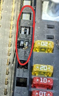

The ribbon connector looks perfect but there is something going on with it.
I cannot remember if the grounds were verified?? That ribbon connector carries the grounds to the BCM.
It truly is difficult to pin down an intermittent issue. A ground may very well test out fine when you test it but come and go in use.
Did anything ever get spilled in the back seat? I doubt that with the cover installed that anything could enter the BCM but that's assuming the cover was in place.
Reason I ask, maybe just the camera, but it appears to have a residue in a few places around the ribbon connection.
I doubt there are any bad solder joints, but is there any way to check underneath the BCM for bad solder joints?
Maybe take some 000 steel wool to the pins where the ribbon connector attaches.
The fuse box looks pristine on mine. I pulled the fuse box today and turned it over to get a look at the wiring and solder joints, but there are 3 covers that look like they are not removable. They look like the factory snapped them in with no way to release the 4 tabs on each cover without damaging them. The ground for the BCM is behind the B pillar cover and it looks perfect. Nothing was spilled on the ribbon connector. I can slide the lock on the ribbon connector and wiggle it while holding it down and get anything thats not working to come on. Either the pins are not making good contact or the ribbon connector has an invisible defect. When it starts and runs and all functions work perfectly, the security light comes on solid. Wiggle the connector and it goes off but then comes back on. Using contact cleaner on the ribbon and pins make it start and run perfect. I'll clean the pins when the ribbon connector arrives, but this TB was garaged kept for 8 years and driven by my wife's cousin. I bought it and have kept it in a carport. No kids ever rode in it.
Well that pic is MY trailblazer and it has no issues!! Theree is a bunch of what looks like dielectric grease on the slider lock mechanism.
Ah, ok, I thought that may have been a pic of the OP's fusebox you were referencing.
Still fooling with this thing. I checked the ribbon connector with an ohm meter and it tested good. Tried a different ribbon connector and same issues. I can disconnect all wires from the BCM, reconnect' and after turning the key to start a few times it will start, run, and have all functions. It's not consistent. I may just be rebooting the BCM if that's possible. Checking all modules with the Tech II shows all active when it's running right. Then the security light comes on but it runs perfect and everything works. I can command the light off but it comes right back on. I checked all the grounds again. All look good. I won't be able to do much more until next week due to Tropical Storm or possible Hurricane Isaias heading toward S. Florida. I have used the Tech II enough now to refresh my memory. It works a lot better connected to the battery instead of the power plug in the dash.
