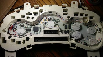

Just use any of the bulb contacts ON the cluster board for the backlighting, and solder the wires to them. Easy peasy and self contained.
Figured, was just curious to which one you guys were using. I recently did that when I put an LED strip in my driver's door module instead of 5mm LEDs

Late to the party but for the led strips in the cluster I couldn't trust the 3m tape because bass. I used that q bond stuff to lock it in place. Just a dab every 2-3 inches.

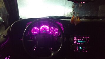

Mine are 5050's. And that last picture was with the strip just on the top side of cluster.
Holy crap that is bright man
Reactions: Midnyteryder196
Midnyteryder196 said:
Yeah I just took it for a spin to check needle positions n once u got out of town lighting, I had to back the dimmer down a Lil.. Lol
