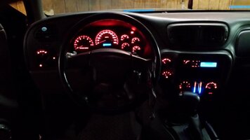

Midnytryder - Does yours have any hot spots or is it a even light across the cluster?
It's really pretty even.. I think it's just the color that is giving the illusion in a couple spots.. But it looks a whole lot better than just the 5mm leds.. Which I did keep in, just removed one to wire in the strips.

The listing expired so sorry no link but it said "Red 3528 SMD Waterproof 300 LED 12V Flexible Light Strip Car Auto Lamp New" I got a lot more then needed (for some other projects).
You can compare them to midnights pics they definitely don't pop like his! :drooling:

I bought the waterproof roll also.. But for the cluster I peeled the silicone off the strip so it would contour to the bezel easily..

Dang that's bright. Personally I feel like the 3528 strips would be plenty bright... I don't like overly bright dash lights.
