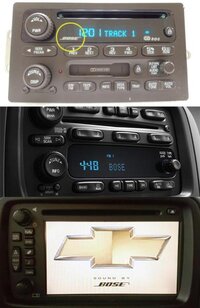

When you turn the OEM radio on it will say BOSE on the display for a second. Also you can look through the grills in on top of the dash to see if there are speakers there. Last in the glovebox look at the RPO code list - UQA should be premium audio. If you tried to use a bose interface in a nonbose vehicle you would normally get very low volume out of all of the speakers. Are you saying the front speakers seemed ok with the harness?

Good point forgot that one! If it doesn't say Bose when turning on it is right on the face of the radio - bottom left of the display I believe?

The older radios should have Bose printed on the display, the newer ones and nav units should say it on the screen when they turn on.

Interesting.. I guess there is always the possibility that if they ran out of radios they would put in whatever during assembly, but being even slightly used I would guess something else happened. Anything from a dealer swap like mentioned earlier, or the truck was traded in with aftermarket equipment and the dealer put it back to an OEM radio, or the face was damaged and replaced with one that said Bose, etc.
