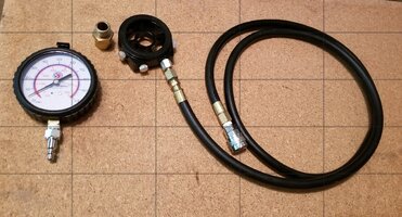

I did an oil pressure test today after it had been sitting for 10 hours. Pressure looks good but one thing I did notice was the oil coming from the filter had a light silver film when looking into the cup I collected it with....this was after about 150 miles on the RedLine 5W-30.
This could mean 1 or 2 things....I have a bearing issue along with severely scuffed pistons...but points a little more to a bearing...again, likely along with worn pistons but hopefully the more predominant noise is a bearing that I can fix...fingers crossed.
Here's the oil test and components used. Matco Oil and trans pressure test kit, Glow-Shift oil pressure adapter.

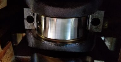

I removed the pan and after a quick look around, the cylinder walls look pretty good, only a slight hint of scuffing on a few of them. I'll poke around more tomorrow when I have more time.
I went to Cyl #4 as that is the one I'm suspecting. The journal looks good, will get a mic on it tomorrow.
The worn bearing material possibly explains the silver film in the oil.
I sprayed the journal with WD-40 so it can sit overnight, that's the drips you see in the inspection mirror.
I checked the clearance with plastigage before I sprayed it with oil, looks like it's at or very close to .003, possibly slightly under...max clearance being .0025.

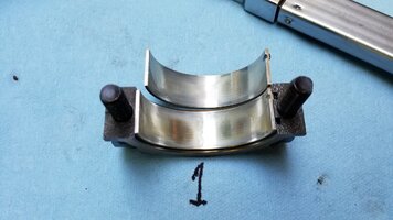

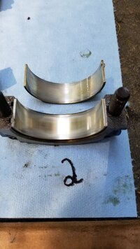

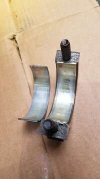

I had to get cleaned up and get to work, but wanted to pull #4 first to confirm at least one suspicion.
All rod bearing will be replaced with OE parts from the dealer.
Tomorrow I will take a look at all the rod bearings and journals, and get a mic on the journals...hopefully in two spots at least.

Time was short today but I was able to plastigage #4 and get a camera up inside.
Looks better but still have a lot more to check. Before and after clearance pic of old bearings and new.
Here's a better look at cyl #2, this is the cyl that I tried to get a 90 deg mirror pic from the inspection camera.
Going back to an earlier post, the 90 deg pic wasn't at the top of the bore, but was near the top of the piston at BDC. Still doesn't dismiss there's wear on the thrust side of the bore but just a better view overall. This cyl appears to be the worst with the thrust side wear.
Quick peek at the thrust side of Cyl #5 since it was also at TDC.

This is #5, something got a hold of the bearing. Miraculously the journal is at least smooth all the way around with no marks.
I suspect a piece of carbon maybe?
mrrsm
Supporting Donor
Oct 22, 2015
8,521
Tampa Bay Area
No... That is NOT an artifact left in the Babbitt Material by a Piece of Carbon... It is a relic of the damage caused when the Pounding Downward Force of Combustion drives the Loose Con -Rod against the Hard Nodular Iron Journal... and literally flattens and peens hard enough to cause the Thin Babbitt coating on the Inner Bearing Surface... to begin to separate from the Steel Shell underneath.
If you have NOT found any actual damage to the Journal... you will have dodged a HUGE Howitzer Round... if the associated Crankshaft Journal bears no similar distortion after being hit in that same general area over Millions of Rotational Cycles.

Trans cooler lines put me back this weekend, but moving forward now. I did start on the bearings today, plan to finish that all up.
#1, & #2 look good, #3 also looks good but I found another chip out of the bearing for #3 on the cap end.
Luckily the journal shows no sign of any damage....I checked the whole journal.
