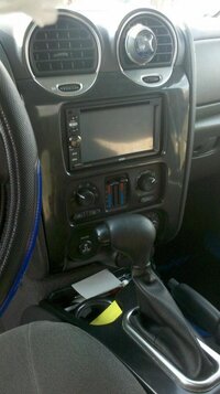

Here is what I have, cheaper one also but is great!! Just do not get a lemon like I did lol
Sorry the pic is really old and the car is dirty

Whats the make and model of that?
It's a Jenson vm9224
