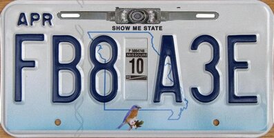

A license mount camera will look cleaner, that cam will either have to be drilled, or you can mount it up by the plate with its universal mount it just sticks out a bit, look at plate mount cams and see which one you like more.
Good I idea I see what you're saying I definitely like the plate mounted one better.

The rear view camera is alot larger than that. My girl friends VW has the same one and it takes up pretty much the entire top of the license plate. Not a huge deal, It works pretty good too. She has a Clarion VX 401.
I went with a hanging one only so I could rotate it when needed, and It gives alot more freedom of movement. It is also HD and has a 180* viewing area, which is very nice with the trailer.
Yea thats a little to pricey but has yet a even cleaner look. Hell even Walmar't wireless system is cheaper then that.

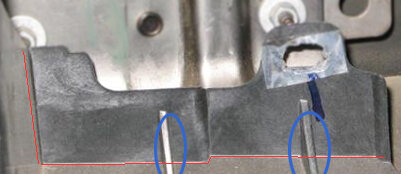

You will also need to do some minor plastic cutting behind the radio for pretty much any double din to sit in there correctly. Not to mention the nav generally is awful, the bluetooth has a built in mic which is a nightmare, and the units overall are just very quirkey. I will add some recommendations but in the meantime what type of phone do you have?

Never did any trimming for any of the DDIN units I have had in my truck (behind the radio).
You can get away with it on some units, but others there just isn't an option. I always cut just because it gives more room for all the cables and ensures the radio will sit correctly. Without cutting the radio has a tendency to aim slightly down and sometimes you have to really push to get the kit all the way in to screw it in. It also helps with air circulation as most radios have the fan on the back and that wall blocks it. I attached a pic of how I usually cut on these vehicles (or any GM really). Take a pliers and break off the two blue supports, then just score along the red once or twice with a fresh blade then break off clean.

Here's a pic of my rear cam was talking about. Excuse the dirt :p
