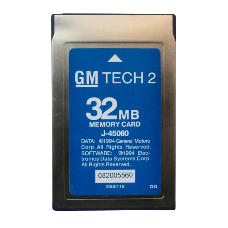

if there was something wrong with the update would the tech 2 still work? I see there is a card that has gm version 33 is that the update them? kinda wish there was a way to find out for sure if the candi is bad or if it is the card.
I think it may be the Candi unit that's defective. The card is fine but may have been reverted to an old update. Check to see if you can select a model year higher than 2009 with cars or other pickup trucks.

So all that to say you need to buy a new card with the latest software version. And it was mentioned in one of those stickies:
Warning: In Tis2000, whatever you do, DO NOT USE THE "SOFTWARE DOWNLOAD" BUTTON! This will retrograde the card in your Tech2 to an old version from 2008.
well i def think my candi was bad at least the new one lite up like its suppose to.. but the card is bad and I have one coming when i got the one with my clone it was only 96 to 2008 that's why i did the update not knowing that 2710 was still not the newest update.... at least this one is prgramed with all the newest stuff
