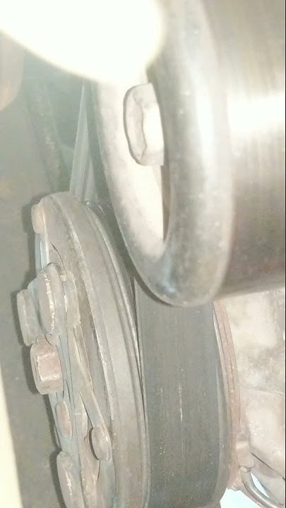

Broke out the Tech2, and I did find the menus for the HVAC, without too much trouble. And it did report the 'pressure switch' as 'normal' (it didn't differentiate between high / low). But, using this was an unfulfilling experience, to be kind, as things that I was ostensibly supposed to be able to command (per my logic)... didn't respond, as I thought they would, specifically with the control head (RPO CJ2 -- the automatic system). I didn't bother with the door mode actuators, as I've not been having trouble with them, and didn't want to *create* any.
Again, I'll spare details. But I'm giving some thought to selling the Tech2, and getting a different tool, for the future. I'll be using it on the Envoy, to see if I have the same experience, there (I know it has no issues with the control head).
Next, I tried jumpering the low pressure switch (the harness plug), at the accumulator (or receiver / drier, as I called it yesterday -- same thing). Had the engine running, and could detect no engagement of the clutch. Again, thanks to Moose for his suggestions, as always.
After that, I checked the underhood fuse box / relays. 2 10A fuses (both good), and 1 relay. Interchanged the DRL & low beam relays (which I know are good)... no improvement.
Finally, I ran across TJBaker's suggestion to jumper 87 and 30 on the relay, which should energize the clutch at all times, given the 'constant hot' on 87.
First, I disconnected the belt from the compressor, so that it would have no resistance from turning. The first time I jumpered the two pins on the box, I thought I might (?) have heard a tiny, tiny faint noise in that area? But only once.
Given that, I think the clutch / compressor is buggered on the Sierra, and I'm going to order one up after posting here.
There *is* one more thing I need to check, and that's to remove the 'deslugger' device I have in series between the compressor and its harness (it's a plug/play, with connectors at both ends, so I didn't have to cut any wiring. But it's a potential failure source, so I have to check that, too, and retest everything above. Depending on results, I'll also breakout the DMM and ensure continuity at all of the system points.
After that, I'm going to grab some more R134a, this time for the Envoy (and for what I'll need for the other two, as well), and see if I can get the A/C running on that one (because I know it worked, previously). Wasn't planning on driving it much this summer, but it's the one that I'll have the least guesswork to fix. Looked up the spec, and since I have the rear air -- which I don't use -- I'll need 2.6lb / 42.4 oz. of R134a for that truck, alone. :yikes:
HOPEFULLY, it'll hold vacuum, and I won't have to replace the rear aircon lines (or find a workaround to block them off, if they're leaking. I already have replacement seals, and figured I'd have to replace all of those -- no biggie, there.
My thanks, as always, to everyone who chimed in, even if I didn't mention you by name. And this thread can stay open, in case anyone wants to continue to add info (and I can also post back, once I get the A/C on 1, 2, or all 3 working again)

Here is a brief look at my 2002 A/C clutch activating and releasing as I jump the relay terminals...
Yes - you figured out I was looking for the thing to *spin*, not be drawn back / energized via electromagnetism. :dunce: Thanks for this. I'll recheck, but I know I would've heard that sound, tbh.

So... my latest...
Took the Sierra back outside, while I wait for it's new compressor (later today), and pulled the Envoy in. Yes... same 21-22" of vacuum. And as I suspected, it didn't hold -- in 30min, it lost all pressure. That's fine, I have seals, right?
As I got ready to replace them, the light bulb went on, and I realized that *this* was the right time to get a rear blockoff kit, even if that wasn't the source of the leak. Searched Google for the kit / info, and where was the best info? Right here, on GMTN, thanks to Mooseman's post from about a year ago. Ordered up a kit from the Bay, and it'll be here in a few days. Which now makes the Sierra the 'winner' in, 'which vehicle can deliver cool, refreshing A/C to me first?'
(For a couple of reasons) I felt like Thanos, in Avengers: Endgame... "You could not live with your own failure. Where did that bring you? Back to me." :hahano:
(as an aside... for some odd reason, I think that's one of the great movie lines of the last 20yrs or so)
So now I'm on hold again for a bit, until I get the new (to me) vacuum pump tomorrow from a guy on CL... a MAC-branded Robinaire, for $65. It's about 90min away, so I arranged a pickup time in the morning, before it gets too hot outside... LOL. And he'll demo how fast it pulls down to +29.xx in., before I hand over the cash. He advertised it as 'quick'. We'll see. I looked for a long time on CL, months ago, before giving up and buying the POS I got from Amazon. Wish this had been available, then. Oh, well...
(Yes, I could rent a pump, and save a few hours (and have a vehicle with working A/C to go pick the CL one up (I knew someone would bring that up)... but I'm still working on the Sierra's tune, now that I got the fuel pump replaced again (which, this time, I dropped the tank to swap it out... which has its own attendant issues. I'll cover that in a different thread.) :coffee:.
So... I'm deliberately keeping the Sierra off the road (and especially highway trips) until I get the tune sorted out. Now that the fuel sending unit issue is resolved (was slow to update), I can finish my tune, using a wideband sensor (yes, I bought one!) I also have a couple of other goodies (tools & parts) that I've been collecting for future use... those'll go in a 'build, pt. 2' thread. I'm thinking some "jaws may drop"... LMAO :shhh:
Anywho... after tomorrow, I should (?) have working A/C in the Sierra... and soon after that in the Envoy. Following up the rear is the one I'm driving the most right now (naturally)... the Accord.
Thanks again, guys. I'll update once I've got some cool air blowing on my sweaty brows 🥵
