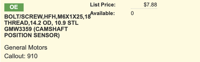

I apologize if I'm asking in the wrong place. Does anyone know what spec bolt is used for the cam position sensor on the 4.2? I have lost mine. I have not been able to find any documentation on it.
