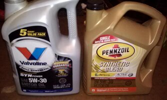

I ran a lot of M1 and have just recently switched away from it due to a lot of people complaining of noisy motors, I started noticing more racket as well. I actually like Pennzoil and Valvoline for readily available oil, never had any issues with them. I recently went with Valvoline Synpower then switched to Pennzoil synthetic blend since I'm going to change it a little sooner for awhile.
